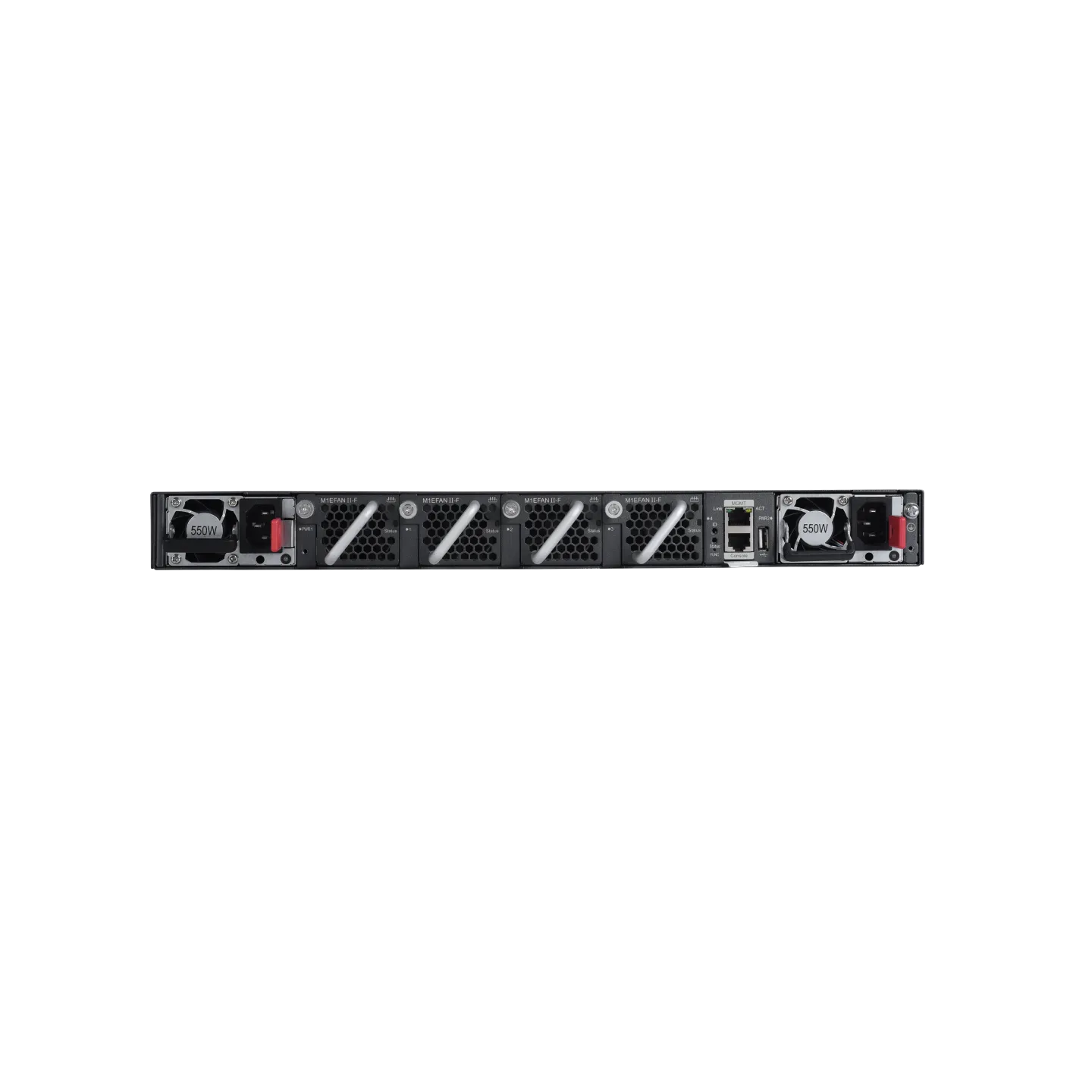

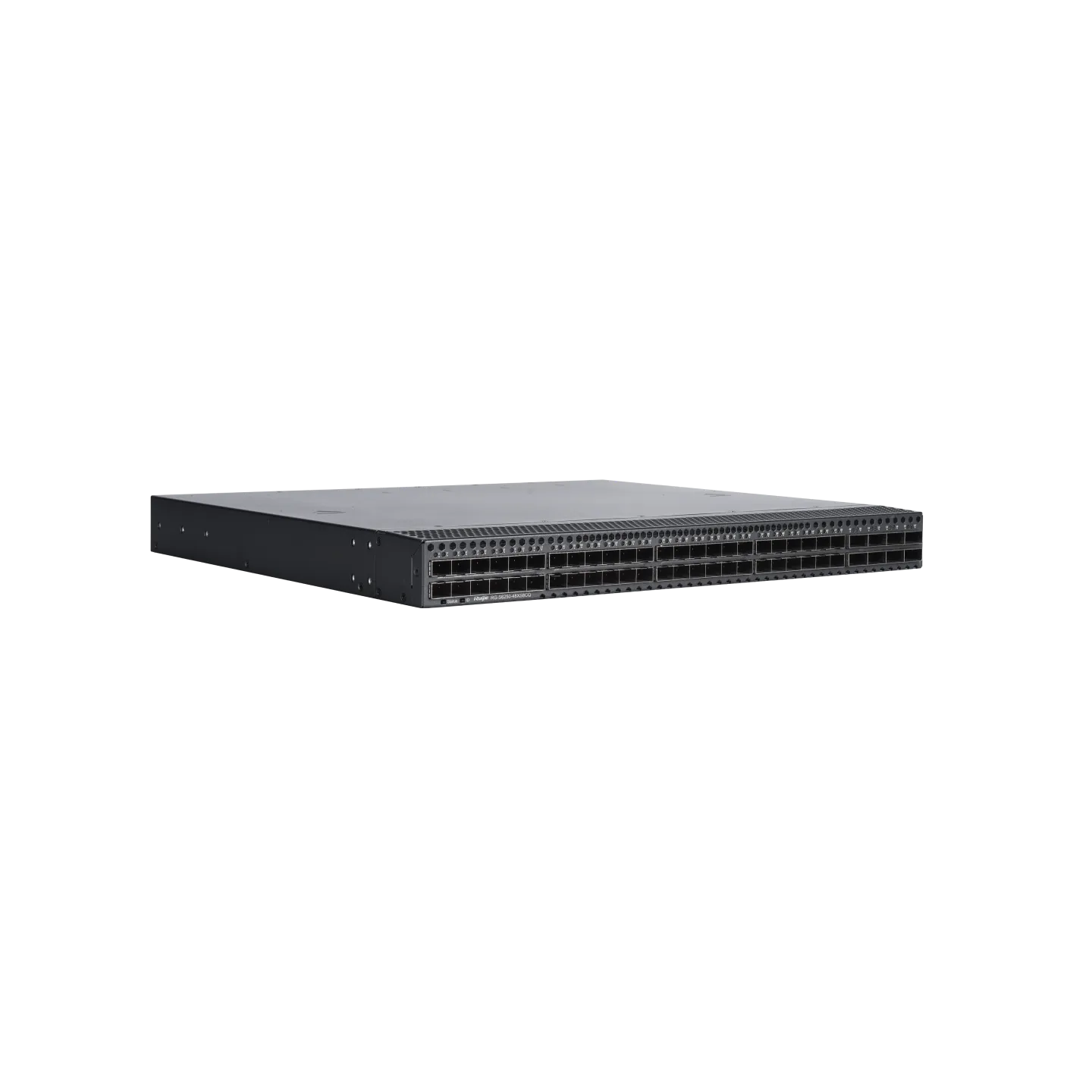

RG-S6250-48XS8CQ 10GE Data Center Access Switch
M-LAG/VSU/de-stacking for higher availability, PFC/ECN-based lossless RDMA network with high performance
  • 48 x 1G/10G SFP+ ports and 8 x 40G/100G QSFP28 ports
  • Cross-device link aggregation (De-stacking/M-LAG/VSU), device-level redundancy, flexible networking, and high reliability
  • VXLAN tunneling technology, achieving unlimited data transmission and flexible resource allocation and scheduling
  • Lossless Ethernet, ensuring zero packet loss during RDMA E2E communication
  • Telemetry/gRPC/sFlow/SPAN-based network monitoring and automated O&M, making management simple and efficient
Key Specifications
View More
Data Center 10GE Access Switch RG-S6250-48XS8CQ
10GE high-density access switch with 10GE/100GE downlink ports and 100GE uplink ports backward compatible with 40GE for adaptation to different scenarios
Large buffer and advanced buffer scheduling mechanism, providing fast data processing and easily coping with burst traffic
Cross-device Link Aggregation, Implementing Device-level Redundancy, Flexible Networking, and High Reliability
De-stacking
M-LAG
VSU
De-stacking technology logically aggregates multiple switches through LACP to allow servers on the same network segment or on different network segments to communicate. This eliminates the need to synchronize data between switches, without affecting service transmission.
PFC- and ECN-based Lossless Ethernet with High Throughput and Low Latency in RDMA Scenarios
With RDMA technology, data does not need to be handled by the CPU during device communication. This reduces the CPU burden
and effectively solves the network latency problem.
PFC+ECN, intelligent data exchange, and packet loss prevention, ensuring lossless data transmission
Telemetry-based Network Monitoring and Automated O&M,
Making Management Simple and Efficient
The switch enabled with telemetry provides clear data status and hierarchy.
The switch uses the push mode to proactively collect and push information and to provide sub-second-level network monitoring in real time, making network management more efficient and accurate.
Specifications
Item
RG-S6250-48XS8CQ
Dimensions (W x D x H)
442 mm x 387 mm x 44 mm (17.40 in. x 15.24 in. x 1.73 in.)
Rack height
1 RU
Unit weight
5.6 kg (12.35 lbs., empty chassis)
8.2 kg (18.08 lbs., a chassis installed with two power modules and four fan modules)
2.56 Tbps
Packet forwarding rate
1920 Mpps
Service port

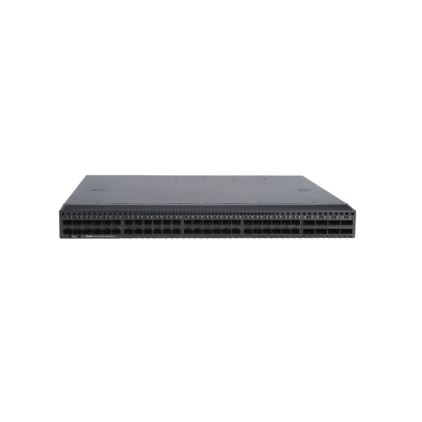

Management port
1 x RJ45 console port
1 x RJ45 MGMT port
USB port
1 x USB 2.0 port (Type A connector)
Module slot

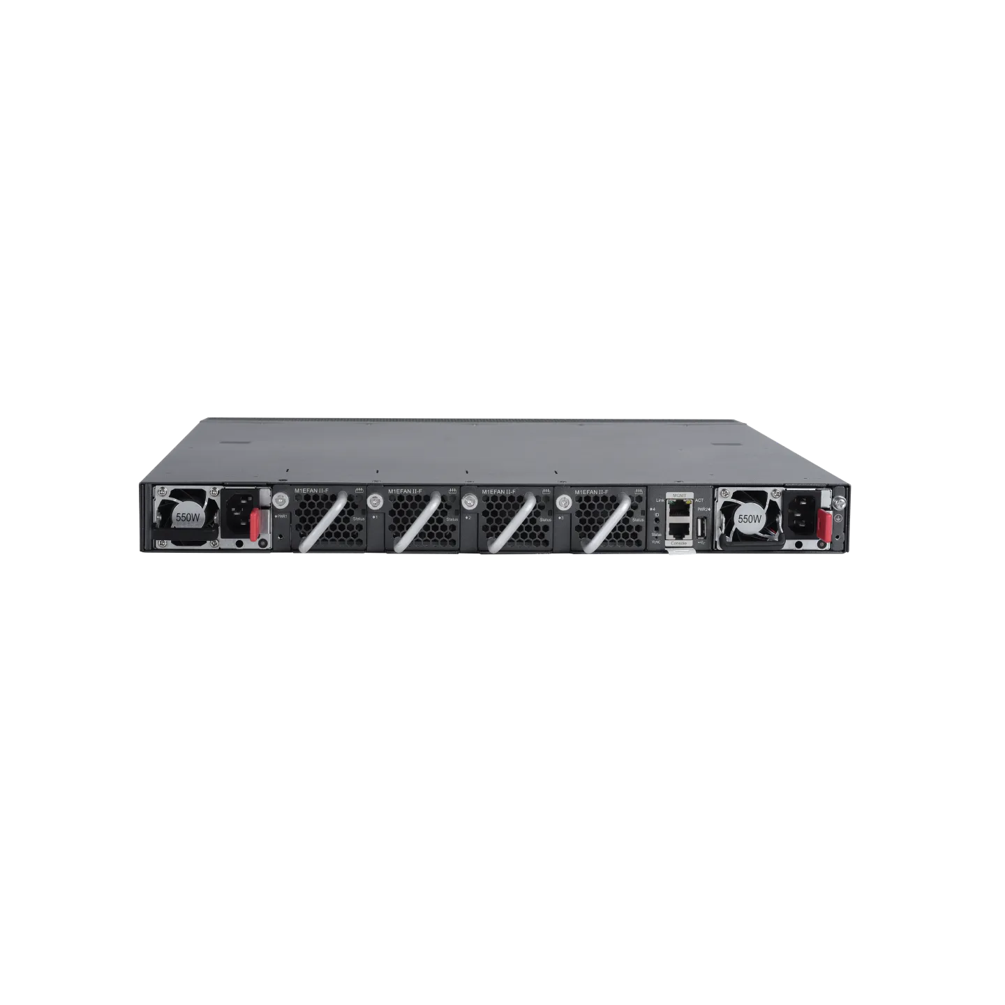

2 x power module slots
4 x fan module slots
Power consumption
Maximum power consumption: 300 W
Typical power consumption: 165 W
Static power consumption: 98 W
Power input
RG-PA550I-F (AC input):
Rated input voltage: 100 V AC to 240 V AC, 50 Hz/60 Hz
Maximum input voltage: 90 V AC to 140 V AC, 180 V AC to 264 V AC, 47 Hz to 63 Hz
Rated input current: 7.2 A to 3.5 A (100 V AC to 240 V AC)
Power port type: C14
RG-PA550I-F (HVDC input):
Rated input voltage: 240 V DC
Maximum input voltage: 180 V DC to 310 V DC
Rated current: 3.6 A
RG-PHD550I-F (AC input):
Maximum input voltage: 90 V AC to 264 V AC, 47 Hz to 63 Hz
Rated input current: 10 A
RG-PHD550I-F (HVDC input):
Rated input voltage: 336 V DC
Maximum input voltage: 160 V DC to 400 V DC
RG-PD800I-F (DC input):
Rated input voltage: –48 V DC
Maximum input voltage: –36 V DC to –72 V DC
Rated input current: 23 A
Power port: three-pin power port
Temperature
Note: At altitudes ranging from 1800 m (5,905.51 ft.) to 5000 m (16,404.20 ft.), the maximum temperature decreases by 1°C (1.8°F) for every 200 m (656.17 ft.) increase in elevation.
Humidity
Operating altitude: ≤ 5,000 m (16,404.20 ft.)
Storage altitude: ≤ 5000 m (16,404.20 ft.)
Cooling
Air cooling, front-to-rear airflow (port-side intake)
