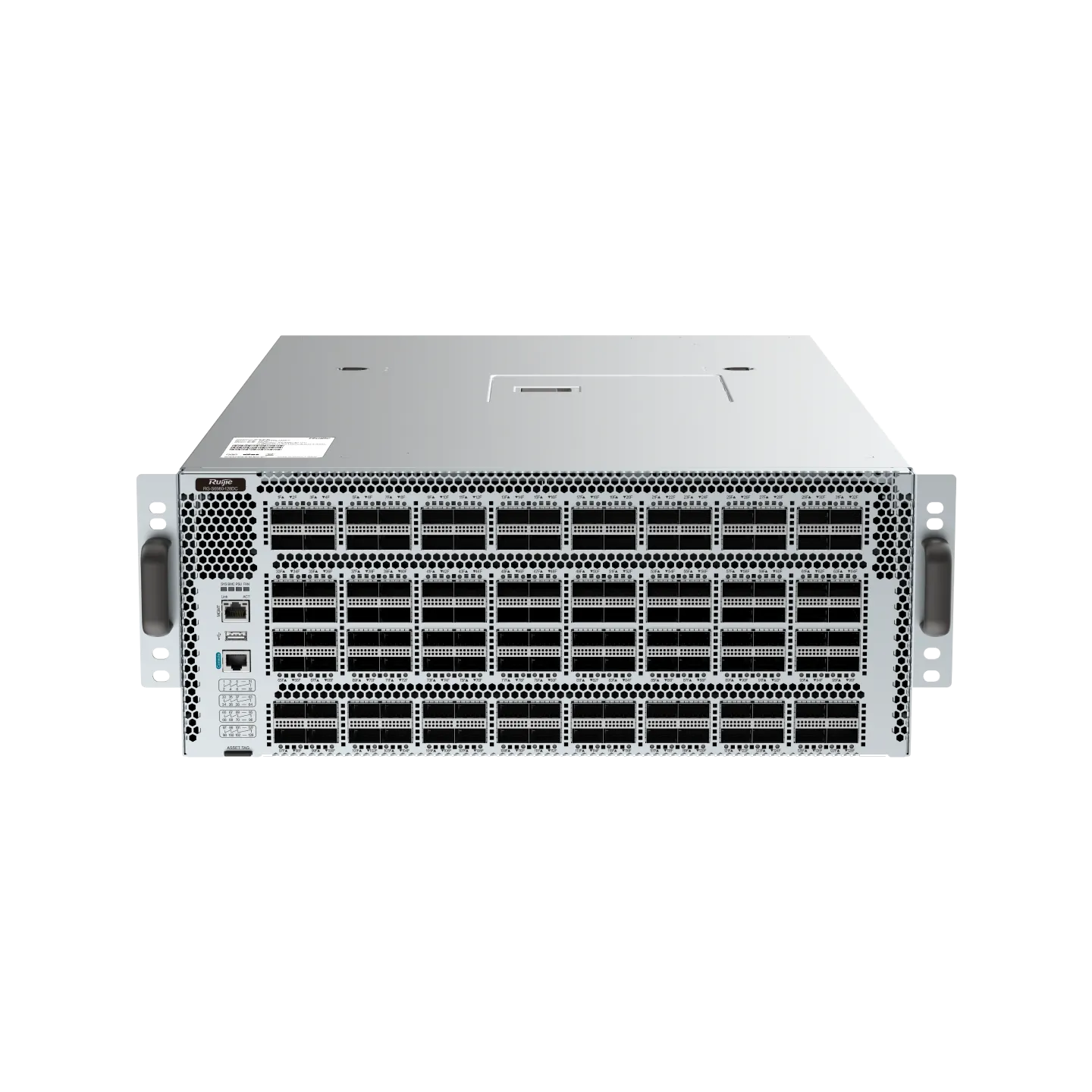

RG-S6980-128DC - 128포트 200GE 데이터 센터 고정 코어 스위치
High-density 200GE fixed switch, support for 200GE optical transceivers
  • High-density 200GE switch with 128 x 200GE QSFP56 ports housed in a 4-RU enclosure
  • Hardware-level redundancy, ensuring service continuity and preventing network downtime
  • Lossless Ethernet, ensuring zero packet loss during RDMA E2E communication
  • Telemetry-based network monitoring and automated O&M, making management easy and efficient
RG-S6980-128DC – 128-Port 200GE Data Center Core Switch
The high-speed and high-density core switch provides 128 x 200GE QSFP56 ports housed in a 4-RU enclosure,
delivering scalable, high-performance, and high-bandwidth services for large-scale DCI networks.

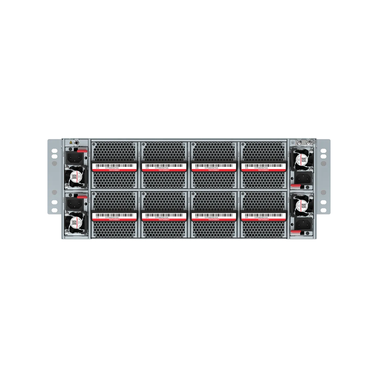

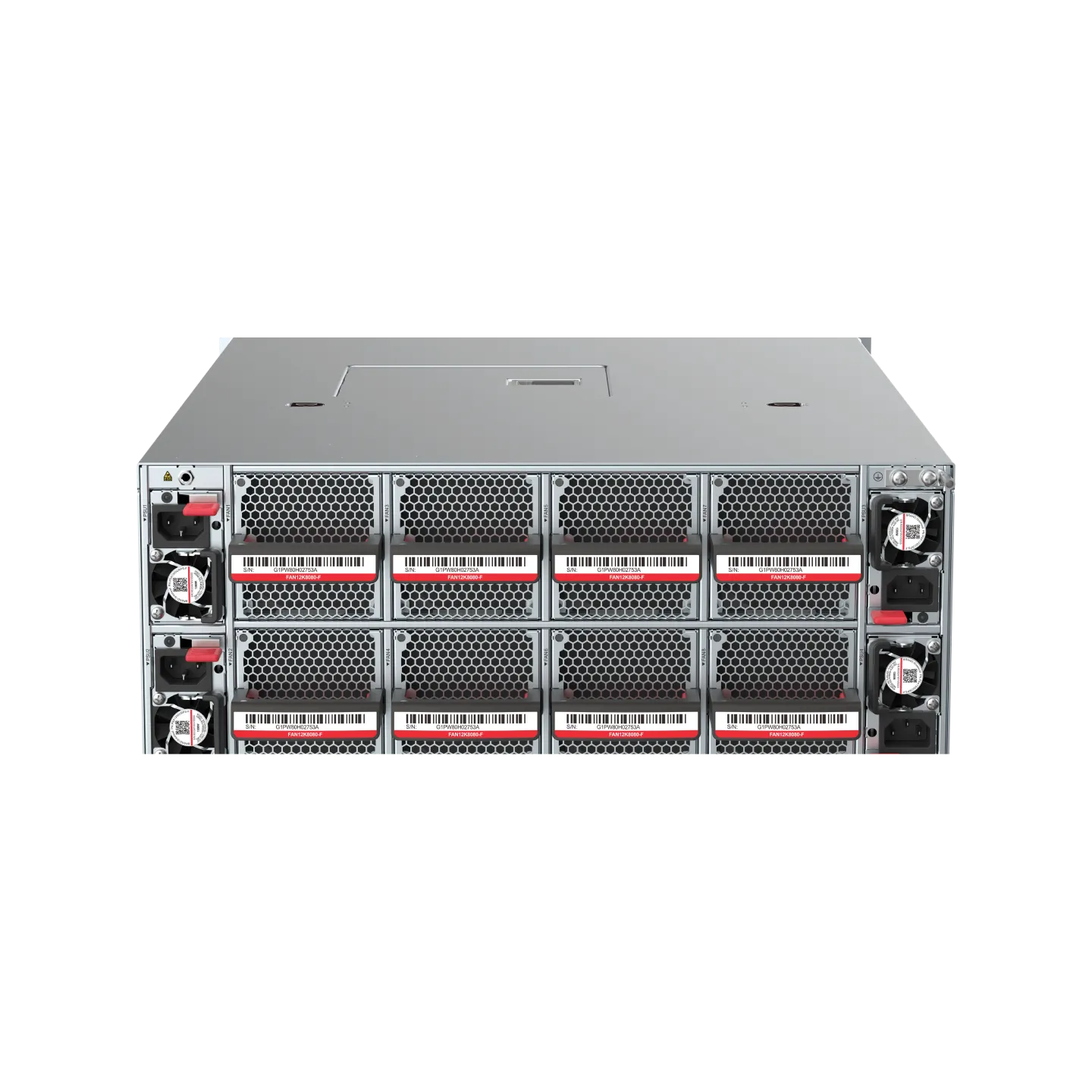

Hardware-Level Redundancy, Ensuring Service Continuity and Preventing Network Downtime
Hot-Swappable Redundant Power Modules
Hot-Swappable Redundant Fan Modules
The switch supports 2+2 power redundancy, enables failover in seconds, and ensures network connectivity during power replacement. This provides dual protection for links.
