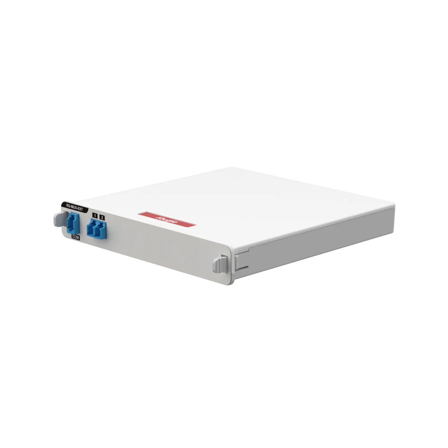

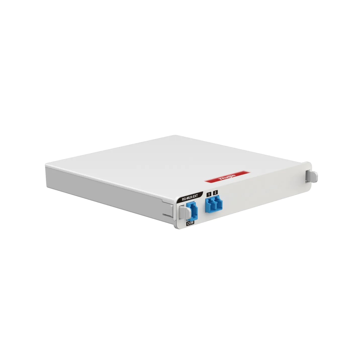

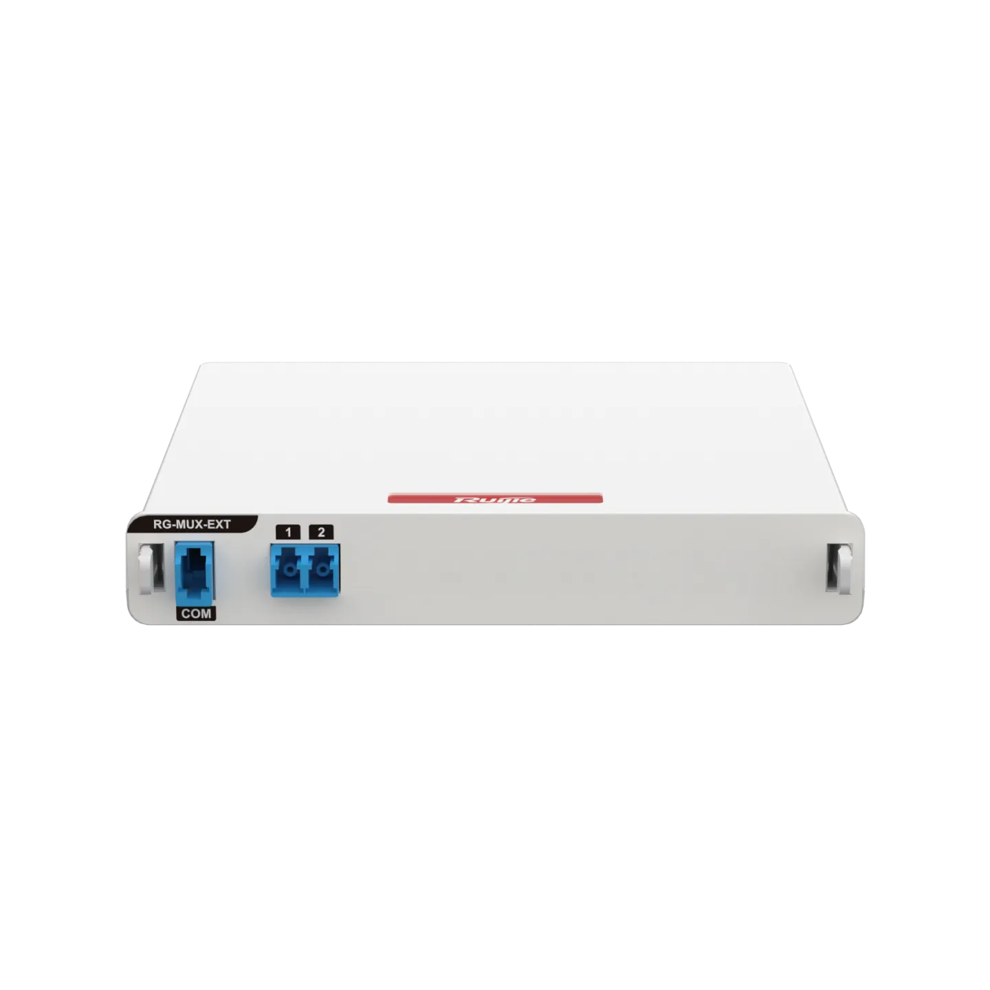

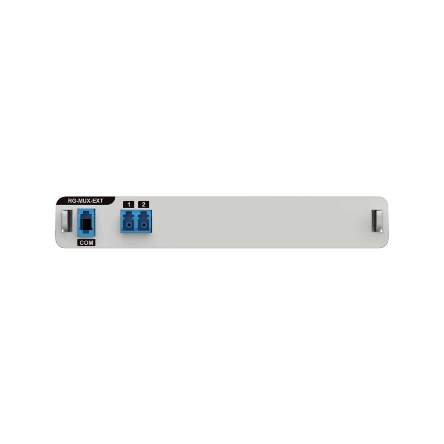

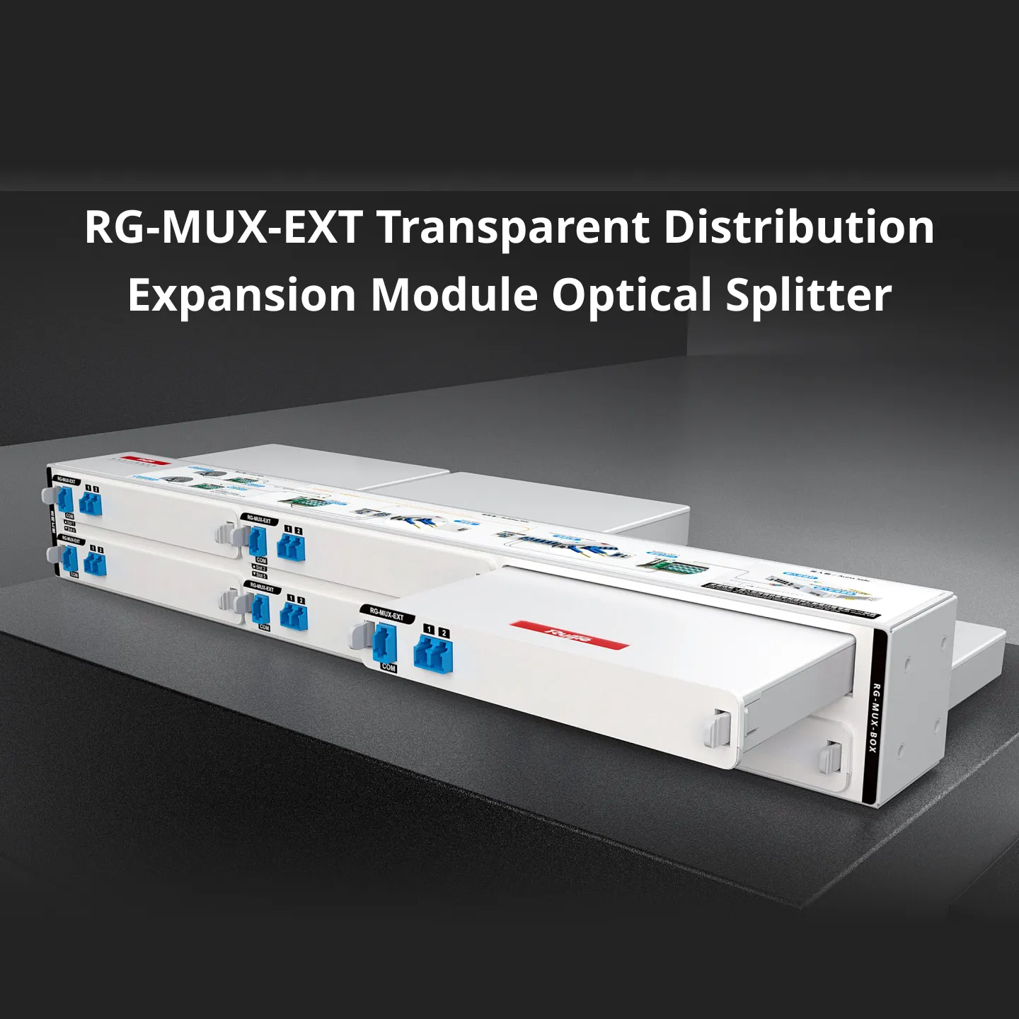

RG-MUX-EXT 투명 분배 확장 모듈 광 분배기
Applicable in VSU networking scenarios, provides two uplink splitting ports, and works together with RG-MUX-8LC/LC-H.
  • Building-side transparent distribution expansion module offering two uplink splitting ports, suitable for VSU networking
  • Splitter and transparent distribution device achieve dual all-optical uplinks, improving link reliability between core and building sides
RG-MUX-EXT Transparent Distribution Expansion Module Optical Splitter
Transparent distribution expansion module on the building side. The optical splitter works together with RG-MUX-8LC/LC-H and provides short fibers and two uplink splitting ports, making it suitable for VSU networking scenarios.

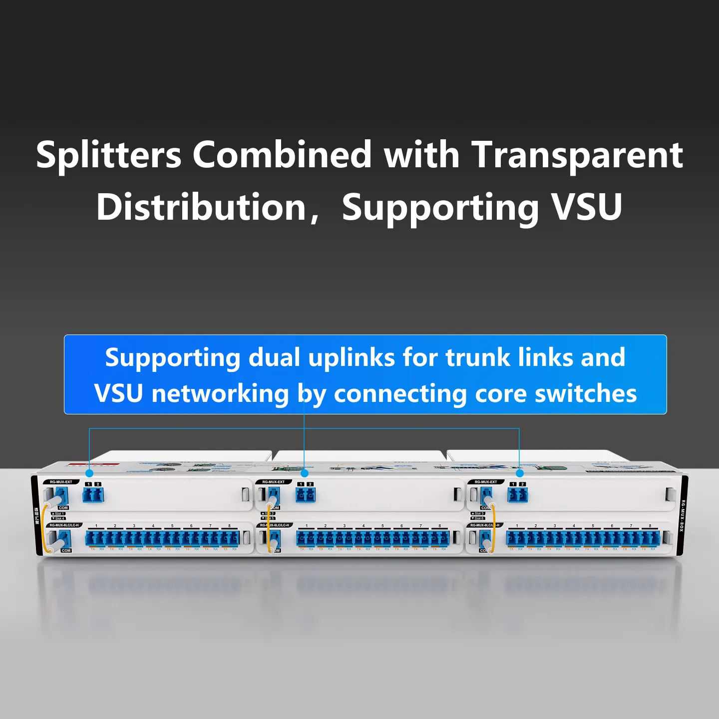

Combination of Splitters and Transparent Distribution Devices Achieving Dual Uplinks for All-Optical Links,
Improving Link Reliability Between the Core Network and Building
The 8-port modular transparent distribution device together with splitters evenly distributes the optical power in a 50:50 ratio to two separate links. This setup allows for dual-uplink networks, effectively enhancing the reliability of the links between the core side and access side.

RG-MUX-EXT
Building-side transparent distribution device's expansion module, or optical dual-uplink splitter (delivered with short fiber jumpers), which connects to the transparent distribution device and provides 1-to-2 optical signal splitting to realize dual-uplink networking; 1 x multiplexing port, 2 x uplink ports for optical splitting
RG-MUX-BOX
Building-side transparent distribution device subrack, 6 x transparent distribution device/dual-uplink splitter slots
