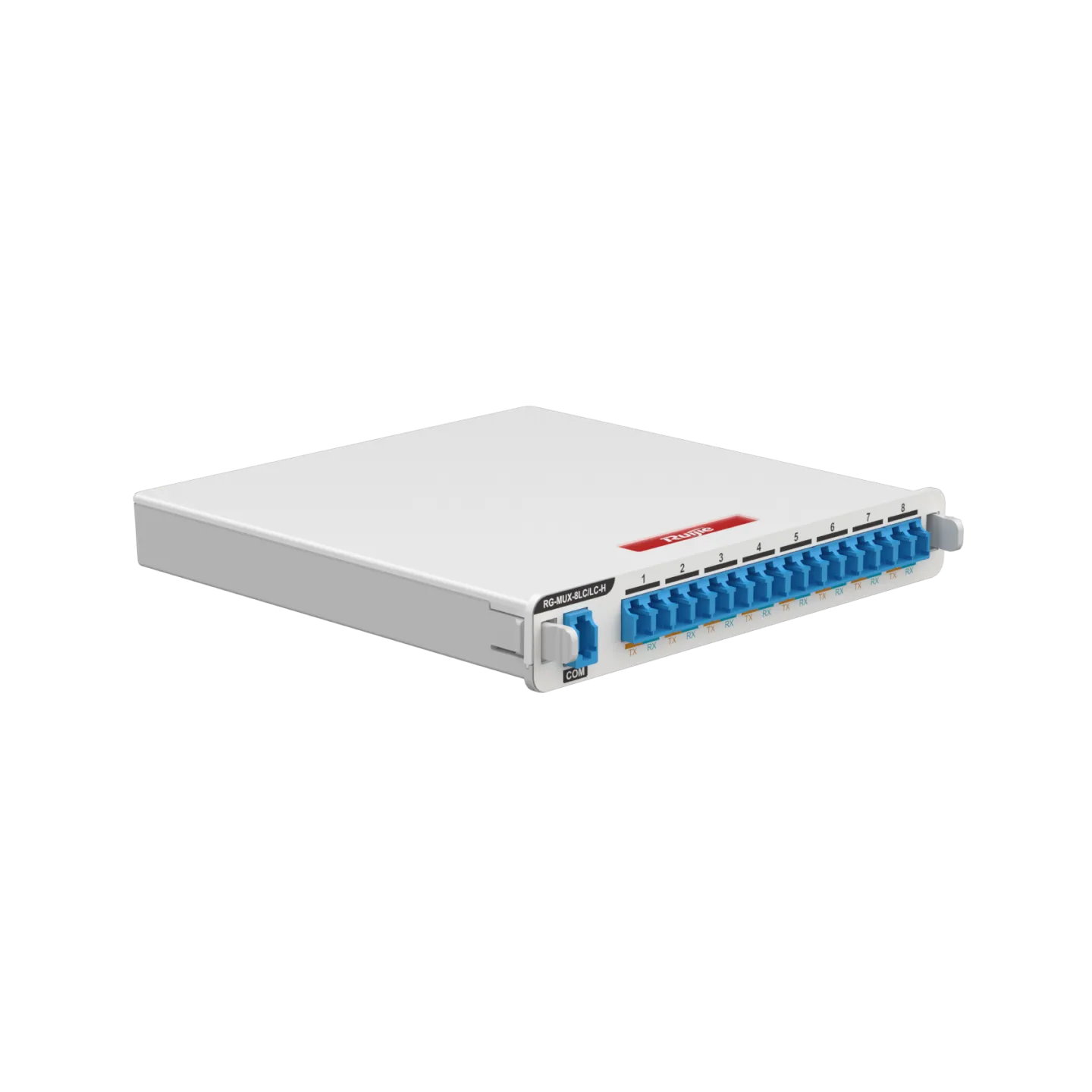

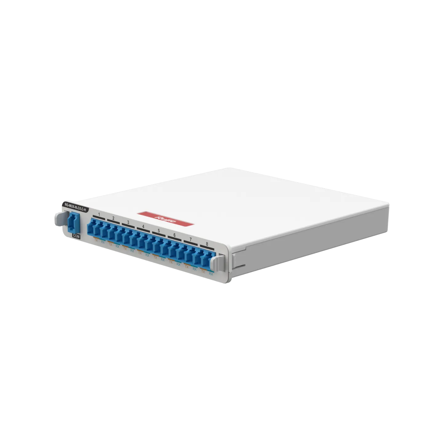

RG-MUX-8LC/LC-H 분배기와 함께 사용되는 이더넷 전광 모듈형 8포트 투명 분배 장치
Paired with splitters to realize dual uplinks on network links and suitable for scenarios with dual core switches
  • On-demand configuration of 8-port modular transparent distribution device, allowing flexible networking
  • Combination of splitters and transparent distribution devices, achieving dual uplinks for all-optical links and improving the link reliability between the core network and building
  • CWDM technology with zero fiber splitting, providing exclusive indoor bandwidth of 10 Gbps
  • Fully passive all-optical network devices, making passive distribution nodes possible and solving the challenges of ELV rooms
  • All-optical deployment, easy to upgrade, and flexible extension of Ethernet networks

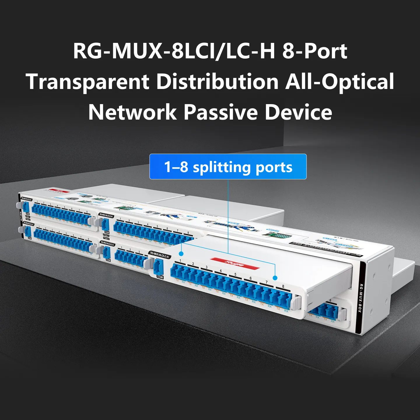

RG-MUX-8LCI/LC-H 8-Port Transparent Distribution All-Optical Network Passive Device
An 8-port transparent distribution device on the building side supports both 10 Gbps and 1 Gbps per port, and can accommodate up to 48 ports when fully loaded. The device integrates WDM technology, which allows for a network architecture reduced from three layers to two layers. With WDM, services from the core side to the access side are transparently transmitted, realizing passive distribution nodes.

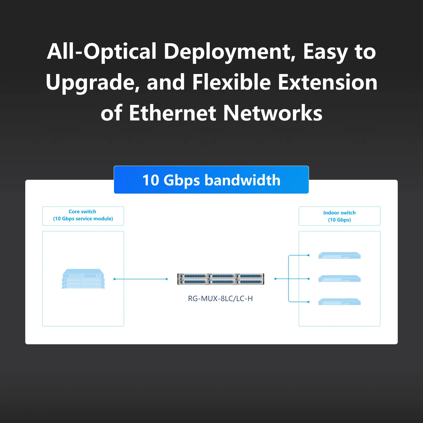

All-Optical Deployment, Easy to Upgrade, and Flexible Extension of Ethernet Networks
Bandwidth can be upgraded from 1 Gbps to 10 Gbps without need to change the backbone cabling area. Switches of different rates can be replaced or added as needed. Transparent distribution devices are plug-and-play, allowing for easy deployment and rapid capacity expansion.

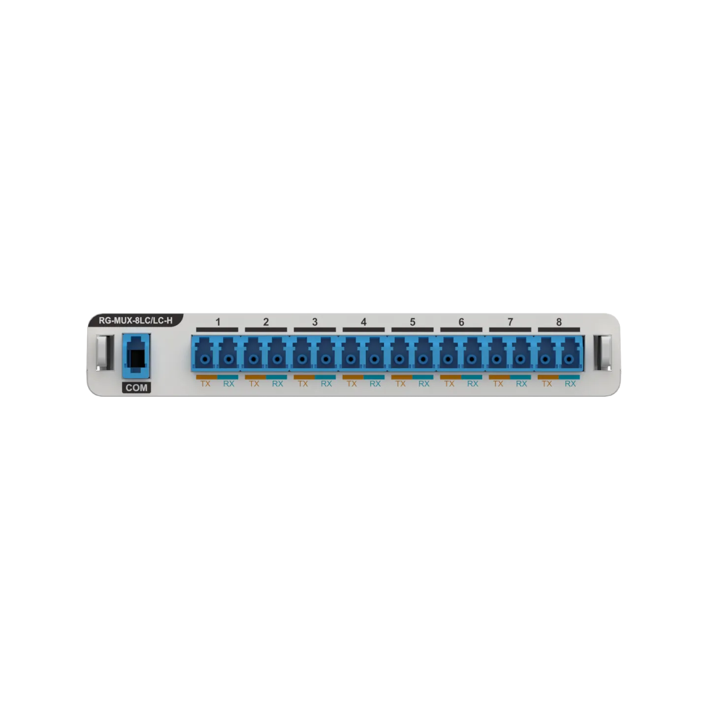

Specifications
Product Specifications
RG-MUX-8LC/LC
RG-MUX-8LC/LC-H
RG-MUX-EXT
Fixed service port
8 x demultiplexing ports, supporting 1GE/2.5GE/10GE
1 x multiplexing port
1 x multiplexing port, supporting connection to a dual-uplink splitter
2 x uplink ports for optical splitting
Wavelength range
1271 nm to 1571 nm (CWDM)
Channel spacing
20 nm
20 nm
20 nm
Channel bandwidth
±6 nm
±6 nm
±6 nm
Insertion loss
< 3.7 dB
< 2.6 dB
< 4.2 dB
Return loss
> 45 dB
> 45 dB
> 45 dB
Polarization loss
< 0.3 dB
< 0.3 dB
< 0.3 dB
Adjacent channel isolation
> 25 dB
> 25 dB
Non-adjacent channel isolation
> 35 dB
> 35 dB
Connector type
LC/UPC
LC/UPC
LC/UPC
Unit dimensions (W x D x H)
149.0 mm x 140.5 mm x 22.0 mm (5.87 in. x 5.53 in. x 0.87 in.)
405 mm x 378 mm x 425 mm (15.94 in. x 14.88 in. x 16.73 in.)
Unit weight
0.25 kg (0.55 lbs)
0.25 kg (0.55 lbs)
0.15 kg (0.33 lbs)
Shipping weight
4.53 kg (9.99 lbs)
Mounting
Mounting on a wall or in a rack (cabinet)
Temperature
Operating temperature: 0°C to 55°C (32°F to 131°F)
Storage temperature: –40°C to +85°C (–40°F to +185°F)
Humidity
Operating humidity: 5% to 95% RH (non-condensing)
Same as the specification of the SOE switch
Communication standard
GR-1221-Core and GR-1209-Core

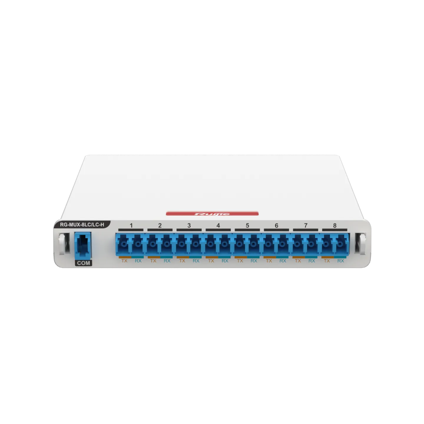

Order Information
Chassis
RG-MUX-8LC/LC
Building-side 8-port transparent distribution device, 8 x 1GE/2.5GE/10GE demultiplexing ports, 1 x multiplexing port
RG-MUX-8LC/LC-H
Building-side 8-port transparent distribution device (high-end version with low insertion loss), 8 x 1GE/2.5GE/10GE demultiplexing ports, 1 x multiplexing port, supporting connection to a dual-uplink splitter
